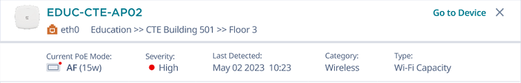

Header
This section provides general information about the anomaly.
PoE Stability Anomaly Header
the header.
The Current PoE Mode shows whether the affected device is online and the current power mode—AF, AT or BT. If the AP is offline, the status is Disconnected.
To get more information about the device, select Go to Device.

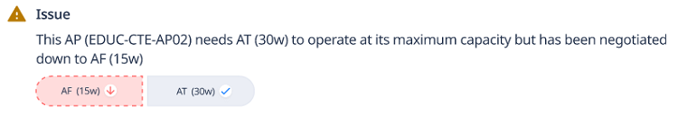

Issue
This section provides a description of the problem, including the actual PoE mode and the desired PoE mode.
Issue
Issue

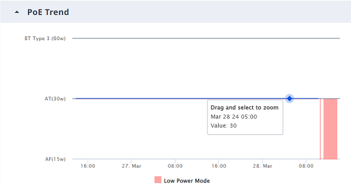

PoE Trend
The PoE Trend graph shows the pattern of changes in PoE mode for the 48 hours prior to the last detected timestamp. To view the graph, select the down arrow.
The graph indicates the three power modes: AF, AT and BT Type 3. Red indicates a low power mode.
PoE Trend
PoE Trend graph
Select and drag across the timeline to zoom in on a section. Select Reset zoom to return to view the entire timeline.

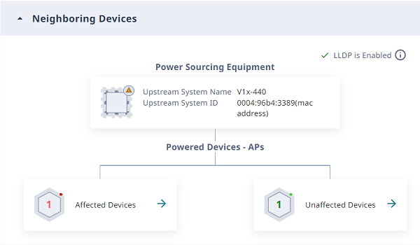

Neighboring Devices
If LLDP is enabled on the AP, the Neighboring Devices section provides useful information for troubleshooting power sourcing equipment, and nearby APs connected to the affected AP. To expand this section, select the down arrow.
If LLDP is enabled and the upstream device is an Extreme switch managed by the current VIQ, the Upstream System Name value appears as a link that opens the D360 page for the switch.
Neighboring Devices
Neighboring Devices section, with LLDP enabled.
Select Affected Devices to view a list of devices affected by the anomaly. ExtremeCloud‌ IQ icons indicate whether the affected device is the current access point, or a neighboring access point.
Select Unaffected Devices to view a list of devices not affected by the anomaly.
The device lists include the following details when LLDP is enabled:
If LLDP is not enabled, ExtremeCloud‌ IQ reports the affected building and the floor, the number of devices affected by the anomaly, and the number of devices not affected.
